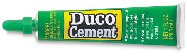

Building my first guitar using a basic steel string LMI kit which includes black plastic binding. The bindings are not holding with Titebond. Probably predictable given that Titebond is a wood glue, but I thought it might still be suitiable. Not so. So do I just use a general purpose plastic/timber adhesive??

I use Duco - available at my local True-Value hardware store. Works on both plastic and nitro celluloid.

I can attest the Duco works well too. Ace Hardware carries it. Hoffman turned me on to it. I like that syringe idea.
My dogs are small and I use Frontline Flea and Tick stuff on them. By purchasing the biggest dog size and sucking it into a syringe like the one above, I can do the entire neighborhoods dogs and do.... love that stuff.
Thanks for that tip Terry, I'm gonna do that for sure. I hate the color of dried duco and rosewood all over my fingertips.

[QUOTE=Mark Tripp] I use Duco - available at my local True-Value hardware store. Works on both plastic and nitro celluloid.
-Mark[/QUOTE]
That's what I use too. Works well.

Thanks everyone for your replies. One of the constraints is that I am in Australia and the LMI and Stewmac glues cannot be shipped by air. But I was able to find something similar to the Duco Cement in our local hardware. The range of general purpose adhesives is overwhelming - they all include a long list of materials that they work well with but plastics are always limited to "some plastics" - so it is hard to be sure - I will just have to try it.
I like the syringe idea for application and got some cheap disposables from the local pharmacy/chemist.vandenboom38921.340462963
